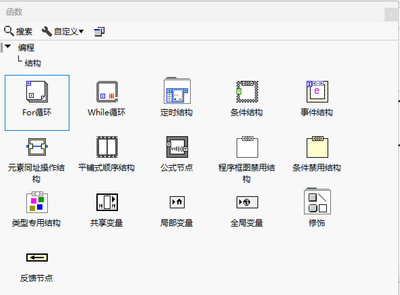

MathScript node is not appearing on plane in Labview 2024 Q1
(886 Views)
I think Mathscript node has been obsoleted and replaced by Matlab Script Node.
You can find the MATLAB® Script Node in Mathematics >> Scripts & Formulas >> Script Nodes.
Reference: How Can I Run a MathWorks, Inc. MATLAB® Script That Uses MATLAB® Toolboxes in LabVIEW?
