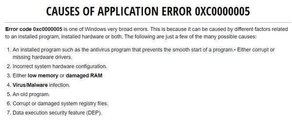

Hi Eggord,
There are many reasons for Application Error Code 0xC0000005 and here are the possible reasons after i googled the error:
Is your matlab code present in the node is causing any of the above problems?
Since i cannot guess,atleast you need to post some code or explain what your code is doing

@srikrishnaNF: Thank you i only googled it with labview as tag. I should have done it without. Most points are ok. Let's see if i can resolve the others.
