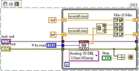

Do you mean you want a single max and min during the whole data collection? Just store your max and min in a shift register. If the new max is greater than the old max, or the new min is less than the old min, store the new value.

While I went off to create this snippet, gregoryj already gave you the same answer.  Here it is again, visually:
-Kevin P
