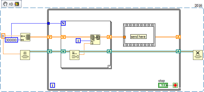

Hi thanks for the reply.
I unfortunately can't allocate the array before use as it is of variable size and it's important that there are no extraneous elements.
I've shown attached an image showing the code that I have trouble with.
I neglected to mention this is on a cRIO RT target, hence the FPGA interfacing.

Oh! with FPGAs and it was necessary to begin.
Of course this is too large an array and so it is impossible.
You have the FIFO buffer, so, wait for necessary size and get all elements as array not by one.
I do not currently have a FPGA module, I can not make an example, but I think it should be standard.

The image shown is the RT VI.  There you can have variable sized arrays.

That's what I thought. It isn't the variable sized arrays that are causing the issue.
I think I may have resolved it though, I was foolishly using a waveform graph instead of a chart when I only want to update one point at a time - something the chart does better anyway. Thanks

In the snippet you have shown, you are appending to an array. Each time you appended to an array it makes a new buffer for the new array, thus you can run out of memory quickly. Can you allocate the array beforehand and insert into the array instead of appending?
