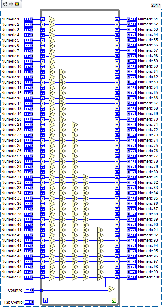

Maximum number of shift registers/feedback nodes per a loop
It seems to work quite well...
Smiley Happy
Greets, Dave
Message 11 of 15
(1,428 Views)
Can you post a screen shot of the code?  I'm wondering if you might have accidentally expanded an existing shift register (so you will get previous iterations), instead of creating a new one.
