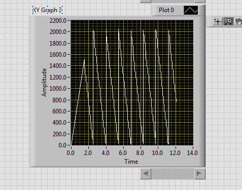

Could you capture data and repost your example VI so we can see the Encoder1 and Time values for XY Graph3? Run the VI, Right Click on XY Graph3 select Data Operations and make current value default. This should save the data to the graph when you save the VI.
