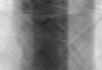

I'm wondering if anyone knows of a utility (inside LabVIEW or the Vision system or anything else) that could measure the angle between the apparent cross hatch in the following image.

If you can manage to threshold the values or if you manually create lines on the image you can use the endpoints of the lines as inputs to the IMAQ get angles VI to measure the angle.  The cross hatch looks pretty weak and it is neighbored but that really dark block, so you may have troubles finding it programmatically.  If you create your own lines the IMAQ get angles should do the trick though.

I need to use the "line" to measure angle of an image like this from above.
However I need two lines to form this angle, and I'm not able to put two lines on the image to perform the measurement.

I searched for lines in two separate directions.  i.e. Top to bottom and left to right.  You'll have to play around with these as well as the orientation of the line you're searching for to get anything useful.  Then you can calculate the angles between these lines.
I found it very useful to do some preprocessing on the image to make it easier to find lines.  For example, no lines could be found in the above image, but after I used IMAQ Equalize.vi on it, I could find all sorts of lines.  This particular function may or may not be helpful in your use case.
Another thing that helped further is equalizing just a small ROI rather than the whole image at once.  This way any stark differences between regions of the image will be nullified.
