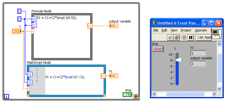

There are a couple of options- although some more details would be helpful.   Are you wanting to combine these two equations into one?  What have you tried so far?
As far as some options, take a look at the Mathscript node, the formula node, or the expression node.  formula_node.png

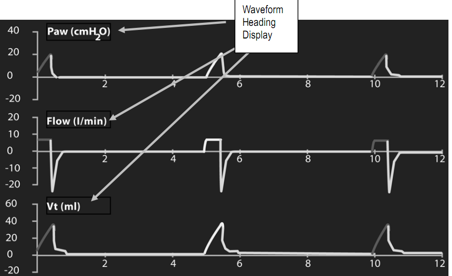

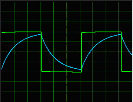

Respiration model can be devided in two parts : inspiration and expiration. Inspiration is modeled using function Vinsp(t)=C1+C2(1-exp(-t/0,5) and expiration si modele using function  Vexp(t)=C1+C2(exp(-t/0,5)).I would like to generet signal as shown on Figure ( blue line ) and show generated signal on scope or graph.  After that signal values will be extracted  every 2 minutes and that would make a log of patient respiration during tretmant with mechanical ventilator. Also, i need to change amplitude ( tidal volume of lung ) and frequency ( breath per minute ) without distorting signal ( incomplete rising or falling edges ).

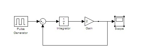

This would be very useful, thank you very much. I think that I found more easier way to implement this but I have some problems, again. This signal is simple pulse response of RC circuit. According to differential equation that describe this system, model that will give wanted output is shown on figure.
How to implement this in LV 8.5? I tryed  but for every solution and alternative I get value 0 after the subtract block in LV. I assume that the problem is something about feedback node?

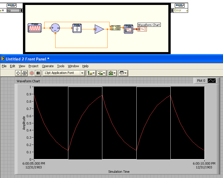

Hello MMozart,
You can use LabVIEW Control Design and Simulation Module for that.

Hi MMozart,
Andy is exactly right.  Do you have Control Design and Simulation Module?

No, I dont have Control Design and Simulation Module. I know that this is the best tool to solve this problem but Im wondering what is problem with VI that I modeled in LV 8.5.In fact, here are the signals Im trying to generate.
