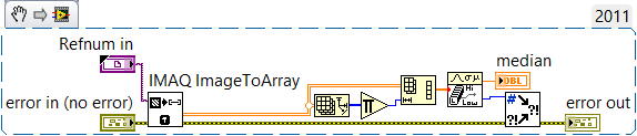

@nanocyte wrote:
I think what you're doing in the in place structure is the leak. Here's two options that shouldn't go mem crazy. Try both.
In general how come in place is leak if it modifies the very same array in memory instead of creating copies of them? If you compare code in my example and your example, your example is actually making more buffer allocations than mine.
Message 13 of 15
(1,713 Views)
I don't know quite how to answer you without a high degree of handwaving. I don't know what's causing your memory leak. The in place does not guarantee that you won't have a memory leak because you can grow your array in there or create new arrays in there. The buffers are only an indication of possible memory usage. The actual memory use varies. Benchmarking and trial and error is probably a better way to reduce memory usage.
I benchmarked my median code and it ran indefinitely and did not have a memory leak. It uses 66MB of memory in 2011 regardless of how many times it ran. LabVIEW is using ~300MB in task manager.

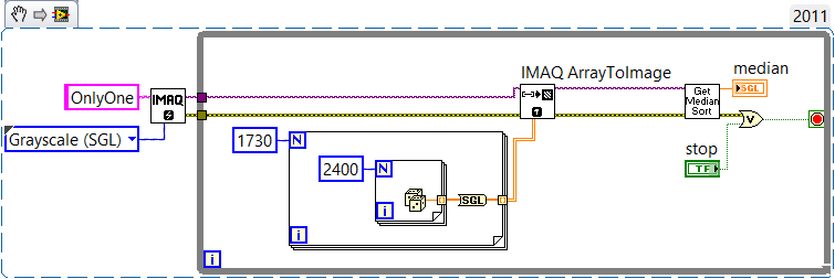

Here's how I benchmarked it:

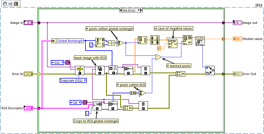

Old thread I know, but I was looking for a way to find the median within a IMAQ ROI. Since I couldn't find anything I decided to try myself. Maybe it can be of use to someone else too.
