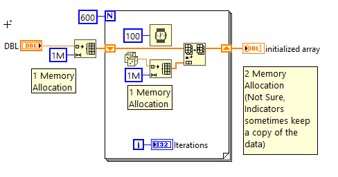

In your example, you are constantly resizing and adding to the array, each time you do this, you will increase memory, as LabVIEW needs to make a new memory buffer.
Look at the following example:
An array is preallocated and then elements are replaced. Memory should stay constant.
