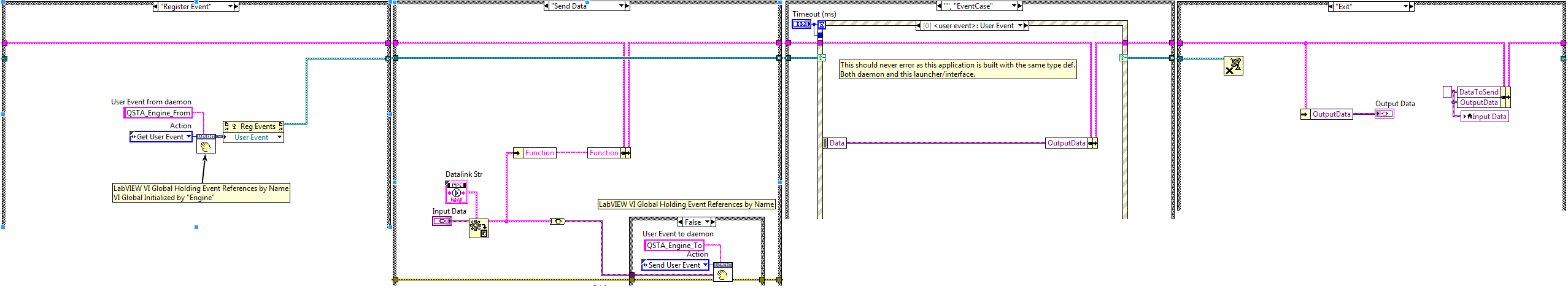

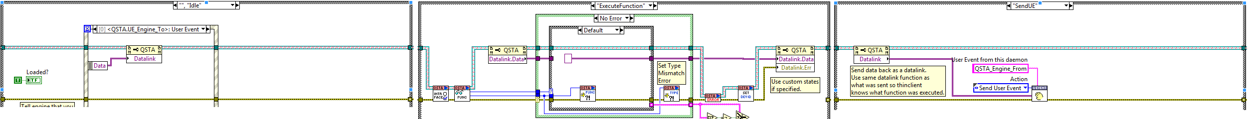

There are two top level vi's in the program (exe in this case).  Use VI server to interface with one of the vi's (lets call it "Interface").  Interface checks if the other vi (lets call it "Engine") is already in memory and running.  If "Engine" is not open then "Interface" opens "Engine" using the path and vi server.  It runs "Engine" with autodispose ref = T.  It then waits until a boolean on "Engine" is set which means the vi has initialized the user event references to use to pass information back and forth.  Next "Interface" will then send the data to "Engine" which includes the function and data using a user event reference (obtained using VI Global method to lookup reference opened in Engine).  "Interface" waits for "Engine" to complete by waiting for a different user event that includes the data sent back from the function called in "Engine".  That data is sent to the front panel \ connector pane of "Interface" and passed back to the originally caller using call by reference node or getting the data via get control value.

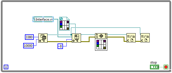

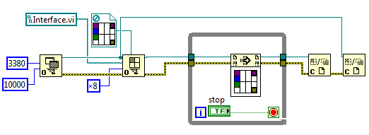

The original implementation used activeX to open a reference to "Interface".  Interface would run, then become idle, then run again, and then idle (Engine is always running).  This approach exposes the memory leak.  I changed the implementation today to use VI server to communication with the VI in the EXE.  If I call "Interface" in a loop by opening "Interface" then close the reference to "Interface" and the application then I see the memory leak.  However, if I open the reference to the app and "Interface" and keep that reference open while looping on the call to "Interface" then I don't see the memory leak.

Caller Memory Leak Not Seen
Caller Memory Leak Seen
Interface States called (Engine Already Running)
Engine States Called (Engine Already Running)

  • What happens of you have just the open/close application reference functions outside the loop?

If you only open and close you don't see a leak.
