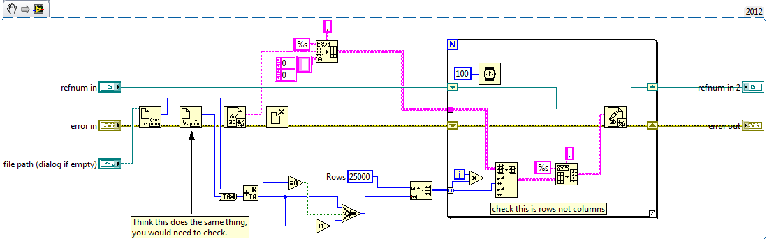

I developed an application which generates a temporary datalog files (*.csv) logging @10ms. after a ~3day test I need to merge all the temporary files to a single file.
implementation: to merge to a single file I am calculating the total line is each temp. File and by reading 25k rows per iteration and I am writing to the main datalog file. when file size  reaches ~400MB. I am getting labview: memory is full error. in the loop I have used "request deallocation" palette', but didn't worked.
I am attaching the screen shot of the code. Please suggest me a solution

1) Deallocate memory does not work as you are thinking it does. You will need to bring the Read of the temp file, the conversion and the write of the data into the main log file into 1 VI to lose the memory allocated for each temp file read. (It is doing nothing at the moment)
2) You can replace the while loop with a FOR loop wiring the an Initialised array of Q elements (default value 25000) + if R =! 0 add the value our of R to the bottom of the array. - this will allow LabVIEW to preallocate memory for the operation.
3 Take your Read Spreadsheet string outside the array - every time you run this you onpen and close the temp file which eats )memory. you could just read tyhe file once at the start and then index the array of elements converting them into strings (see method described above)
4) can you replace the while loop with a FOR loop based on the number of files?
5) Try using the Set File Size and Set File position to pre-allocate the size of your destination file before you start your initial read.

Your biggest issue is the Read From Spreadsheet File.  Why are you reading it out as an array of strings just to turn it into a string.  Just read the file as a string and then write to your main file.  Nice and simple.
As large as your file is going to be getting, I would highly recommend changing over to TDMS.  Having that large of a text file will drag down almost any program trying to process it.  TDMS will make life a lot easier.
