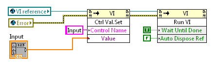

First, I have a vi for opening a secondary vi:
Then I have a vi for calling the opened, secondary vi:
These two are compiled to a dll. The first one is called once, calling a function "open(char *)". The second one is called over and over, calling a function nextevent(double *, int). A simple example of an opened, secondary vi looks like this:
The code used to send data looks approximately like this:
