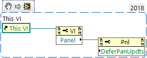

“Defer front panel update” – How do I do that?
Look in the application Control Palette.

“Defer front panel update” – How do I do that? I left a link in my message: https://forums.ni.com/t5/LabVIEW/Example-for-Defer-Panel-Update/td-p/3688130,  read it, basically it is achieved using property nodes.
