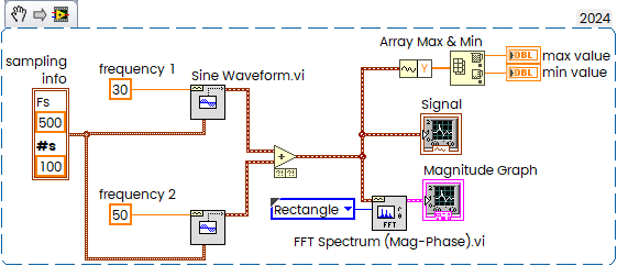

Hi! I'm not sure what you need exactly, but usually the FFT is used to analyze frequencies. If you need the minimum and maximum values from an array, then you can use the MinMax primitive. The following snippet may be helpful for you — here two sine waveforms with different frequencies of 30 Hz & 50 Hz mixed together.:
or may by working with array will be more easy to understand:
Result:
For further questions just attach piece of your code, please.
