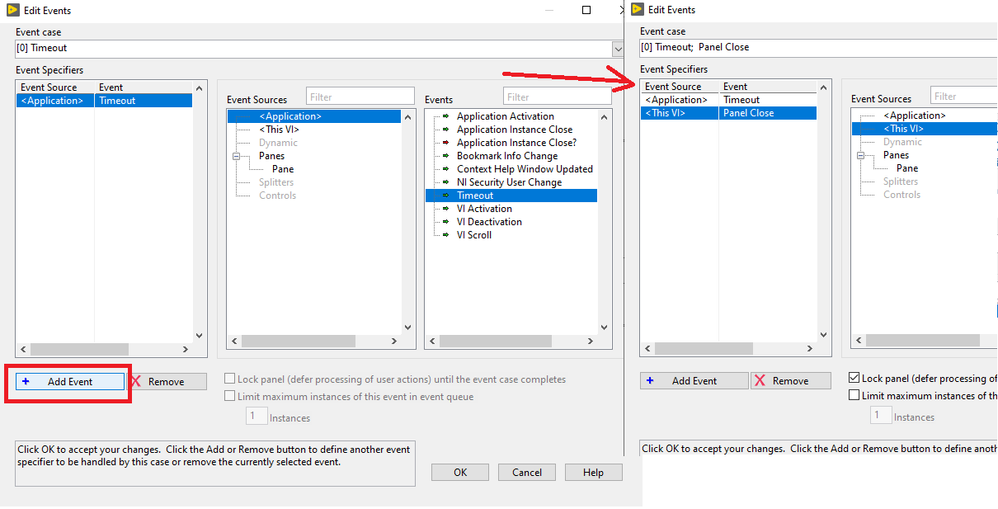

Part 1 can be handled by adding multiple Events to a single case:
Here neither event is tied to a control, but you could certainly do that.

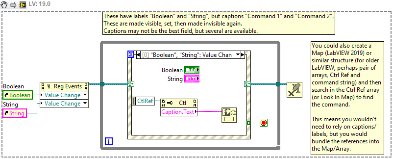

Part 2 can be handled by using the Label, Caption (perhaps) or perhaps Description to define the command. A vague example is below:
A backsaved copy (for 2015) is attached.

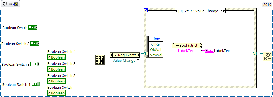

You can add multiple controls to a single event case.
Then you can use the terminals on the inside of that case to get a reference to the control that fired the event.

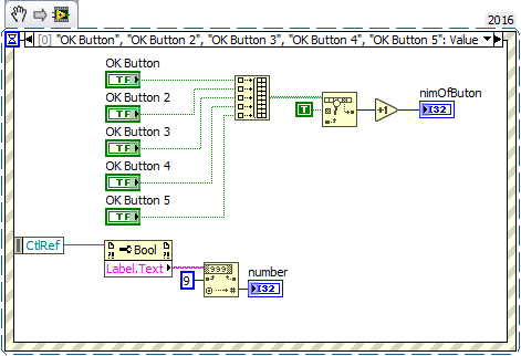

Would something like this work? You could always get the references in a subVI.
mcduff

To be fair all these options seem to be unfriendly to the programmer. I fully agree a large cluster that is just set to be invisible is a horrible idea. It seems fairly crazy that there is not a way to decuple the front end from the back end. So far I prefer the last example given although it still is less than ideal. Thank you to everyone who gave examples.
