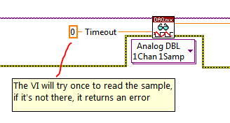

Wiring 0 to the Timeout of a DAQmx Read results in LabVIEW's attempt to read data ONCE? This can be a useful troubleshooting or benchmarking tool to ensure (for example) your producer is synched up to your comsumer.

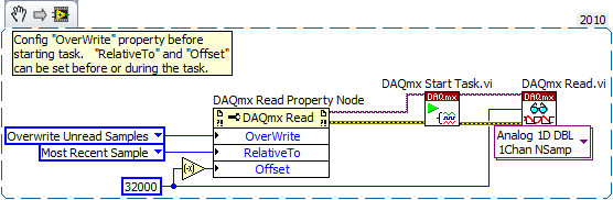

Another neato DAQmx trick to avoid waiting is to use DAQmx properties to control how you access the read buffer.  I've done a lot of apps that didn't need a contiguous, lossless stream of data, but *did* want to be able to show "what just happened" at any given moment.  Here's a snippet I made someone recently to illustrate.  (Note that you could choose to set or change the "RelativeTo" and "Offset" values while the task is running.)
-Kevin P

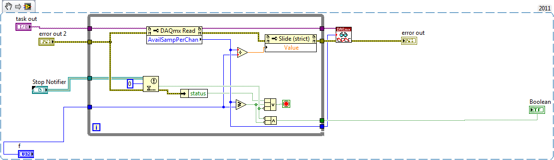

I used the property node retain control whilst waiting for a long data acquisition, could be several minuets, this allowed me to place a thermometer style progress indicator on the pannel & use a notifier to stop acquisition DAQ.png

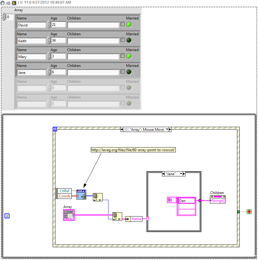

Problem - you want a grid with a dropdown box in one of the columns. You create a typedef cluster with a combobox for the dropdown. The items in the dropdown are identical for each array element.
Solution - change the items on the fly. This uses Array Row Point To Row.vi by JDave on Lava.
The "Children Column" below effectively has unique selections for each row.
