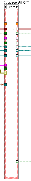

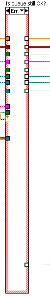

Occationally we find that we have to add a new case to our code and wire up a bunch of shift registers as shown below.
This technique save wear and tear on our wrists.
Start by squishing
Then wire!

Nice idea. Remember to turn off Auto Grow for the structure before squishing.
