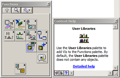

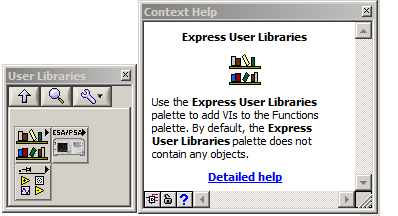

By default, the express user libraries are empty (see also).
