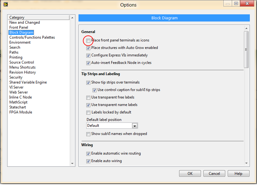

Right-click the terminal and unselect "show as icon".
There is also a configuration option that determines what kind of icons you get when creating controls or indicators.
(3,802 Views)
The configuration altenbach mentioned can be found by navigating to "Tools > Options..." - select Block Diagram from the category and then uncheck the "Place front panel terminals as icons.  This will change the default, if you prefer the smaller form factor. Smiley Happy
