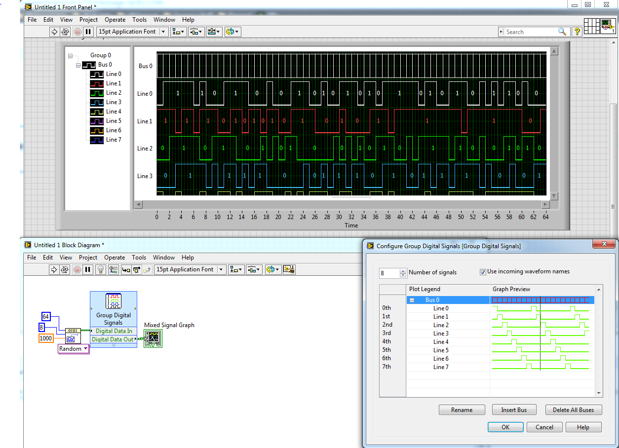

Thanks for your reply - this restores hope that I might be able to get this to work. However, when I tried your identical code, I end up with a mixed signal display that shows only the lines, not the bus, and I don't see any options that would allow me to change this (see attached).

Sure, no problem - see attached. I believe this should all be identical to your example.

I just discovered that if I right-click on one of the "Line" signal names, I can uncheck "Expand Digital Busses" and get a bus display instead of the line display, though I still can't get both at the same time. The bus is still named "Line 0" by default, but I can change the name. This is probably all I need for now - I don't need bus-and-line capability for the current application.

Now a new issue arises when I attempt to place more than one bus on a Mixed Signal Graph. The code and front panel screenshots are enclosed. Each of the "group digital signals" VIs is configured the same as the yours. Only the trace for the second bus shows up on the display. I've changed the names from the default "Digital 0->Line 0" (both busses orignally had this name) to "Bus 0" and "Bus 1". Both busses show up in the "Group 0" tree on the left, but only the latter is displayed. When I right-click on the bus names in the tree, both "Plot Visible" options are checked.

I tried duplicating the code and was seeing the same behavior as you.  But just now I was playing with it and realized Mike's message is missing an important step.  When the dialog box is open, select all of the lines, then drag them up and drop them onto the bus line.  Then the results look like what is shown in Mike's post.  Without doing that, you essentially have 1 empty bus and 8 individual lines.  Doing that drag and drop turns it into a bus consisting of 8 lines.

On your earlier screenshots, are you sure you dragged and dropped the lines?
I did not drag and drop the lines, and my dialog box and the results looked exactly like what your screenshots showed.
After I dragged and dropped all the lines, then it looked like Mike's screenshot.
