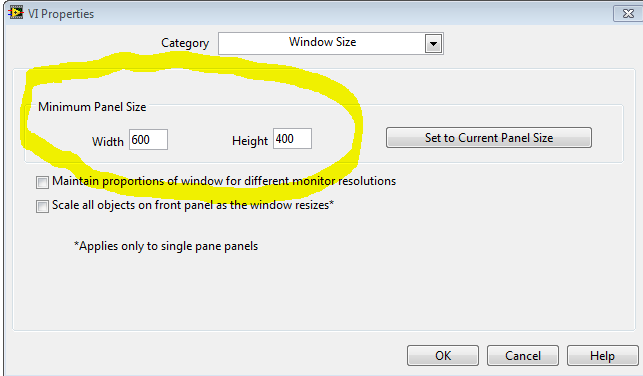

That looks like a known feature of the MSG improperly resizing with the panel.
It is probably best to set a minimum size for the vi (VI Properties>> Window Size)
Then the user can't cause the problem
(2,796 Views)
Thanks Jeff,
I have set a higer value now for the new version where I rebuilt the graph from scratch (changing it on the old one with the messed up graph had no effect though). For now it´s working, let's see if it stays so!
