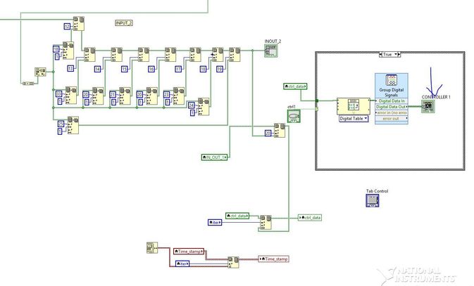

Currently I´m trying to paint a digital data as if they were a chonogram. Periodically I take samples and store them in order to avoid representing contiuously the data, which lags the equipment under test.
I have 40 signal and a time stamp for each sample in 2 variables.

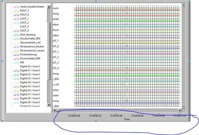

On the image you can see how more or less data is created and time stamp is saved. My problem is how to include the Time Stamp as an X-Axes. Tried looking for it in properties of the mixed graph but couldn´t find it. Can you help me please. What I want is to load time stamp the representation.

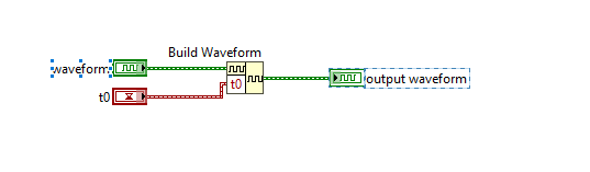

Use Build Waveform function to add time to your digital data graph.
