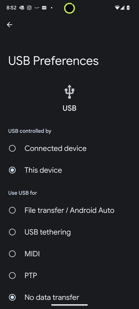

When I plug my Pixel 6 (Android 13) into a computer USB port it defaults to "no data transfer" mode for security reasons.
Simply go to the USB Preferences and change that to File Transfer/ Android Auto
I believe if you enable the "Developer Options" you can change that default behavior to file Transfer/Android Auto

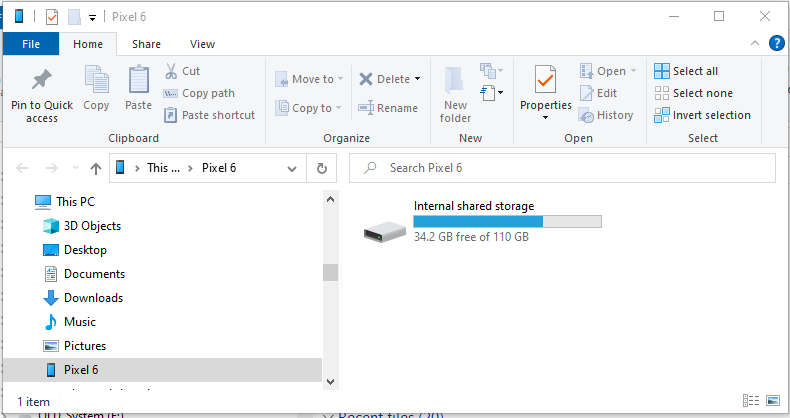

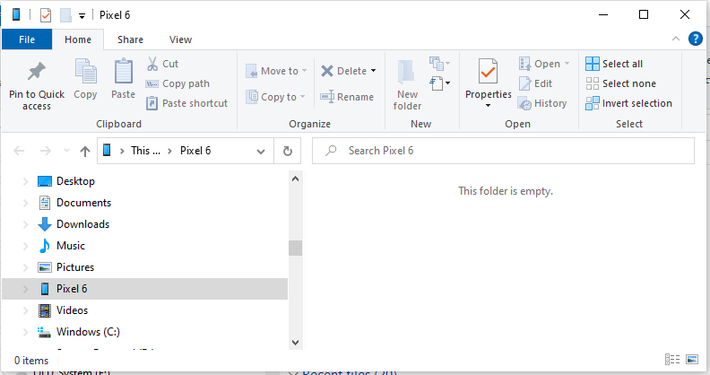

Um... Yeah, that's basically what I was saying. If you change the default behaviour of Android from "Charge only" to "File Transfer / Android Auto" when plugged into USB your phone will appear as a USB drive to Windows.
Here's how my phone appears in Windows:
Default when USB is plugged in
DefaultDefault
After selecting "File Transfer / Android Auto"
File Transfer / Android AutoFile Transfer / Android Auto
Notice the Phone's internal memory looks like a USB drive to Windows.
