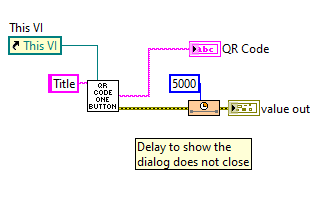

The calling VI is actually a subpanel, and there are 4 sub panels on my GUI.  So the dialog gets a refence to the calling vi (in the subpanel), and then centers itself on the calling VI.
Once you press the OK button, the dialog should close, but it does not until much later.  I can duplicate the issue with a simple calling VI
The QR Dialog Testing.vi calls the dialog subvi, enter any value for the QR code, and then hit the OK button on the dialog.
The dialog will remain open (with the OK button depressed), until the 5 sec timer runs out on the QR Dialog Testing vi and that VI stops executing.

Hi Kenny, the dialog closed right after I clicked the OK button. (LV 2020). I had to delete the green "Align" VI because I don't have it installed. Can you try again with that VI deleted? Just wire FP.Winbounds straight across.

I am still seeing the issue unfortunately.   I have this version of LV 2020.  I am seeing the same issue in 2018 on another Pc I have, with and without the Snap to Center VI.
FYI - The Snap to Center VI is part of the LavaG UI tools Package.
I have tried to mass compile the VI as well, and rebooted LV and the PC.
I attached a video of what I am seeing.
