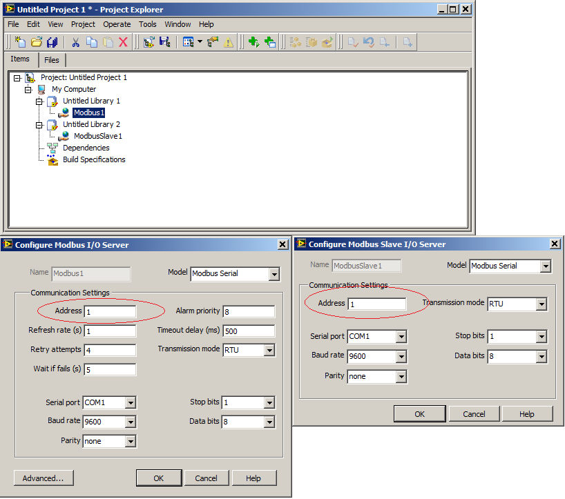

Apologies I can't open your project.
Here is what I see when I mock one up.

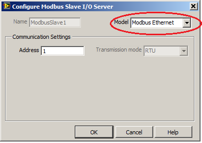

Is it possible that you have selected modbus ethernet (TCP/IP) instead?
Modbus TCPIP is a different Beast.

Timmar, Thanks. I did do that. But the address in your picture is used to specify the server's own address. How about specifying the address of the remote server so that it can connect to it?

The Master and Slave addresses need to be the same, I think this is so you can multi-drop modules on the same bus.
In my example it is 1 on the Master and 1 on the Slave, so - Connect!
Since it is Com port to com port there is no need for additional addressing.

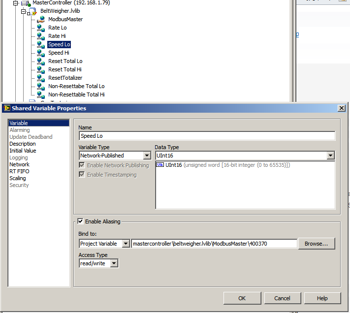

Attached is real world variable
