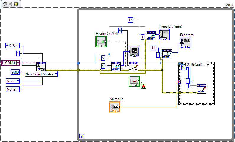

Hi everyone, I have some Modbus Labview program  that controls the heat flow and temperature and I couldn't understand the working principle of that VI. I searched a lot. I look at modbus holding register address formatModbus wiki,MOdbus and etc but I couldn't solve the system. I put the snippet below. Can anybody explain what is the 5,9,11,17 and in the case structure 1,2,3 and 4 stand for? And in create serial master vi, there is parity and flow control part. The 'time left' and 'program' should be indicator but in here it is control. The RS 485 adapter is used. I couldn't understand all of them with respect to the internet pages that I searched. Can anybody give me a detailed explanation?  What do we expect? Thanks in advance.ModbusModbus

       Lets break down step by step.
1) Intialise the Connection using COM3.
 Inside the while loop:
2) Read Holding Registers.vi : This subvi is used to read the register information, Well there are 4 Inputs [(connection ref and error ), (Starting Address and Number of registers to read)]. In your program the starting address is '5' and No. of registers to read is '1'. This register mapping should be clearly stated in Manufacturers protocol manual. This register address 5 indicates some variable (eg: Voltage, current, power.....).
3) Write Single Coil.vi : Its a bool Input meaning you are switching something wrt Register address '9'. [This register mapping should be clearly stated in Manufacturers protocol manual.]
4) After this again you reading Holding registers 17 and 11 with same no of inputs.
Inside the Case Structure:
 5) Here you are writting single Holding register : address is 11 and you are writting 2 registers. The "Numeric" gives input to the case structure. 1,2,3,4 stands for some function inside the case structure.
Note : This is not the effecient way to program. Try to learn some basics and look at some examples. Please read the modbus information here http://www.simplymodbus.ca/FAQ.htm, it simple and gives you a clear picture.
If you need any help. Send me the details i can help you.

Hi jay0909;
Thanks for replying. I see. Thanks for the link. I will search for that. One more thing. What is the parity(odd/even) and flow control (XON/XOFF etc.) in create serial master vi. ?
Sincerely.

Flow control is probably none.  But that and parity would be whatever your device says it needs to be in the manual.

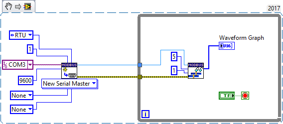

Hi again 🙂
I can successfully handled with it. I solved the problem. Here this program is for only one slave, but I have 4 slave. I want to see data on each slave and put it into a waveform chart which each of them  comes from different addresses. I put the snippet below which includes the only part of the vi. Only reading the coming datas seperately. How can I find the each addresses/channels?

When you have 4 slaves, you'll have to do 4 different Modbus Reads, one with each of the slave ID's assigned to it.

      Did you go through the protocol? Each slave has unique ID so try to communicate one by one first and then try 4 slaves. If you provide me more details i can give you my library which communicates with multiple slaves.
