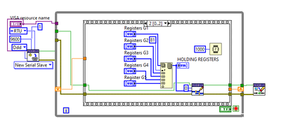

I am facing an issue while communicating with a system using Modbus RTU protocol.
This system (master) sends 5 set of fixed queries one by one. No access to the master (pre-existing)software.
I have created Modbus slave response to this system as per the protocol in LabVIEW.
There are 3 such identical systems, out of which I was successful in communicating with one system but facing error in other two.
My device is connected to this system via Serial to RS485 converter.
I could read the queries sent by the master which is exact as defined
1) 01 03 00 00 00 51 84 36 H
2) 01 03 00 51 00 51 D5 E7 H
 and so on.
But the response I send to the queries is not reflecting on the Master.( The same which is working with one of the system).
The software in all the three systems are  identical as informed.
If there is any issue in the signal connectivity then I should have not received the queries.
Stuck!!
Can anyone suggest if I am missing anything?
Attaching Screen shot of my slave response
Thanks in Advance.

You have three different machines running similar Master Software and Your Slave Module running?
Have you tried available NI Examples to check whether it works fine, Also Compare the Installed Software in all three Machines.

Thank you for your prompt response.
Yes three different machines have similar master software running as informed by the proprietor.
Unfortunately, cannot check much at the Master software side. Please suggest
The slave response I have attached is working fine on one of the three system.
I have checked  NI Examples and my slave response is working with MB Serial Example Master.vi.
I have also tried using termination resistor of 120ohm.
Please let me know if anything that I could verify further.

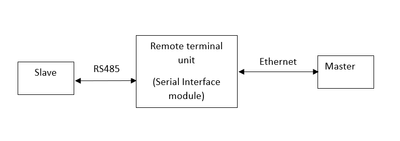

Any Hardware's Involved here? Do you have any Programming Manual available for Master Program?
The hardware involved is a serial interface card as shown below
The remote terminal unit basically converts the RS485 signals and Ethernet and is connected to Master.
The serial interface card has jumper settings for half duplex and full duplex RS485 and also for termination resistor.
I had doubted the serial interface module, but confused because receiving query from master. If there was issue in hardware i think there should not be any query. Correct me if I am wrong?
I have received a communication protocol for interfacing with master. It has format of master query and for slave response.
I can not share the entire document but will sharing the communication settings and master query and slave response format.
Baud rate: 9600 bps
Parity: No parity
Data bits: 8
Stop Bit: 1
Offset in Holding Register Address : -1
Turn around time: 100 mSec

Looking forward to your reply.
