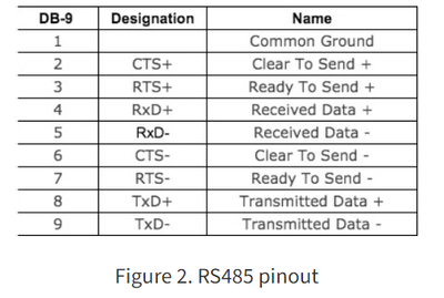

PC -> USB -> USB-RS485 converter -> DB9-DB9 cord -> Breakout Board
Breakout Board:
Meter Pin -> Board Pin
7->5
6->4
5->9
4->8
Per the Flow Meter's Modbus communication manual
and DB9 pinout
ruede014umnedu_4-1727474331067.pnghttps://www.virtual-serial-port.org/article/what-is-serial-port/rs485-pinout/.

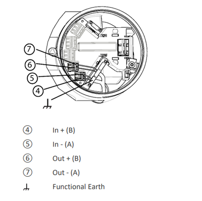

It is not really clear what sort of pinout the DB-9 connector on that box has. It's definitely not safe to ASSUME that it would have the pinout you show in your last link, unless the documentation states so, and I don't see anything like that. There is NO standard RS-422/485 pinout for DB-9, every manufacturer tends to do its own thing! Instead I would use the screw terminal connection which is what is documented in the Quick Start Guide document you linked at.

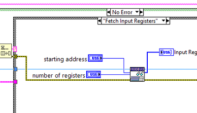

Thank you very much for your reply ZYOng. I don't need QModMaster right? I figured I can test it with my modbus device by sending a simple command and getting a response. I downloaded NI Modbus Library and have the master example open.
What all do I need to modify in this code for it work with my modbus slave device? So far I've made it create a New Serial Master instead, although I'm not sure what VISA resource name I'm supposed to feed it. Do I also need to specify the starting addresses and then I'm good?

Thank you very much for your help rolfk. I got that library I just need to figure out what to change in the example now. Also, I believe that my wires were incorrect. In the flowmeter manual it says it is 2-wire RS485 so now I am going to wire pins 4 (IN+) and 5 (IN-) of the flowmeter to pins 1 (TX/RX-) and 2 (TX/RX+) on the converter as the Quick Start Guide outlines. I believe pins 6/7 (OUT+/OUT-) are for daisy chaining to other additional slaves/flowmeters?

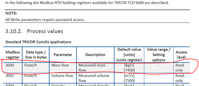

Ok so for example if I want to read the mass flow rate per the documentation I would use fetch input registers and set starting address to 3000 and number of registers to read to 1? I don't need to go into any of these sub vis and change stuff correct? Sorry I am very new to this, I appreciate the guidance.

I believe number of registers should be 4 according to your documentation.
I believe you wanted to say 2. Modbus registers are 2 bytes, a float is 4 bytes. Also the next value to read is at address 3002,  indicating the previous register occupies register 3000 and 3001. Now we only need to know the order in which to put the two u16 to get a u32 that then can be typecasted into a float (a LabVIEW single precision floating point  number).
