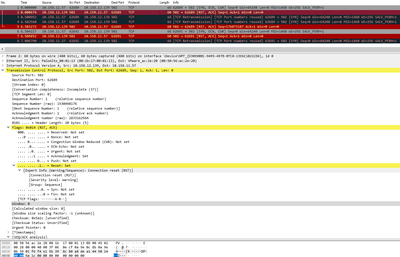

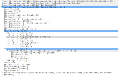

The master application tries to stablish connection and sends a SYN, ECN, CWR packet to the controller.
Packet 1
Then the controller responds with a RST packet.
Packet 2

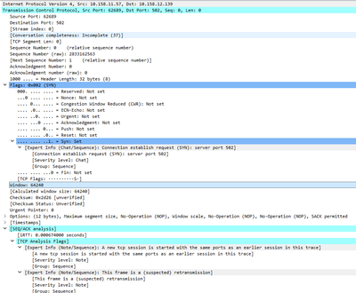

The Modbus Master tries to resend the packet with modified flags SYN only but is unnable to connect:
Packet 3
