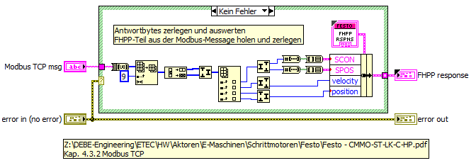

I recently wrote my own driver for a Festo CMMO-ST device.
As the Modbus messages used by the device are so easy to build/parse I went for simple TCP messages (instead of any Modbus library in between).
Parsing the FHHP message looks like this:
(Basically get the 8 data bytes of the FHPP message and put them in a cluster.)

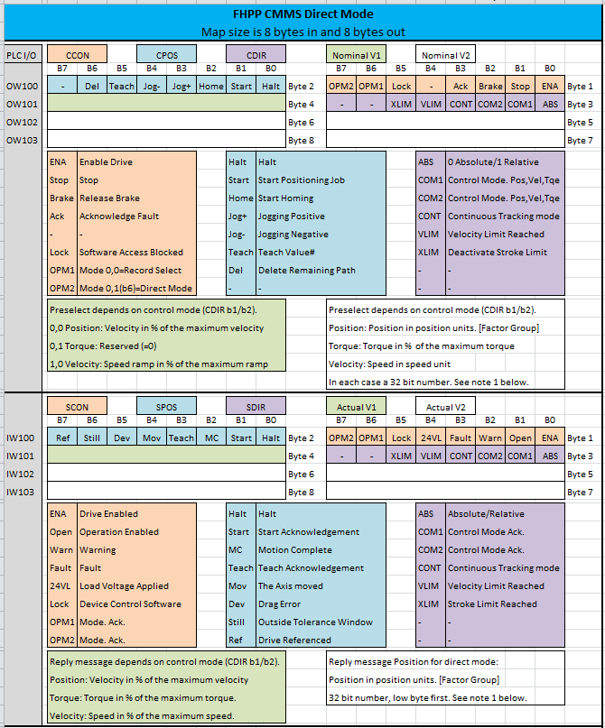

First of all FESTO provided me with this very nice 'cheat sheet' for FHPP commands which can save some time going through the manual! They also have their own modbus TCP client that they can provide to you - it is a good way of figuring out the commands to you need to get the motor running! All of my inputs in the first 3 bytes are false except for Brake, Stop, Enable, Halt, Start, Reset and Home. They are changed based on if you are starting, homing or stopping the drive.

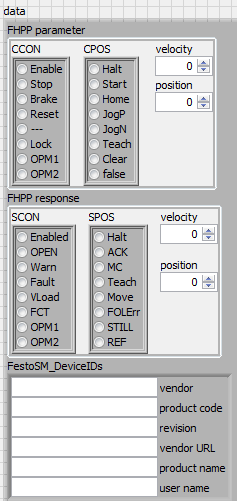

Above is what my front-panel looks like for the input conditions selected......also I think I'm using FHPP+ rather than FHPP which is the reason for elements 5-8 in the array. These are not needed (as far as I can recall) if you just go with FHPP control.

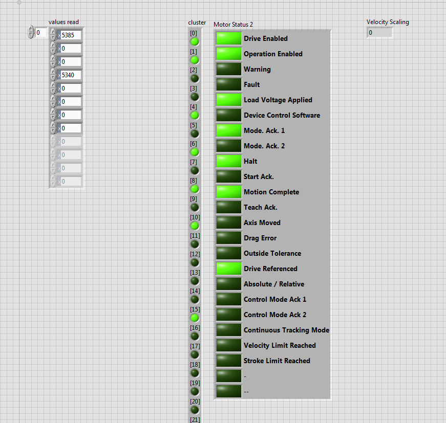

For parsing the data received back I used the following vi:
And here is what the front panel looks like for a typical read of data
Hope this all helps,

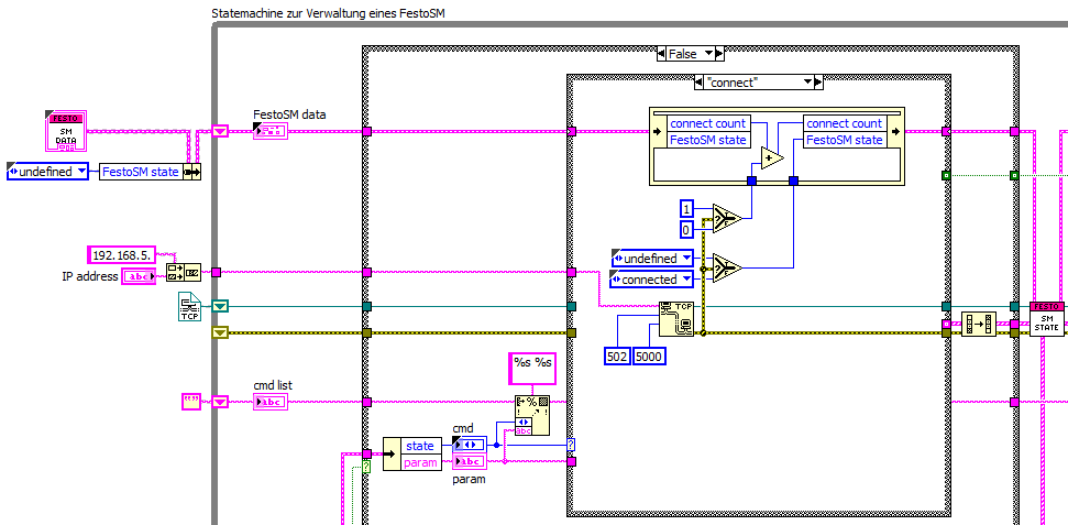

Hi One,
So just…
Yes.
Just those 4 basic TCP functions!
That's the "connect" state of the statemachine controlling one Festo unit:
