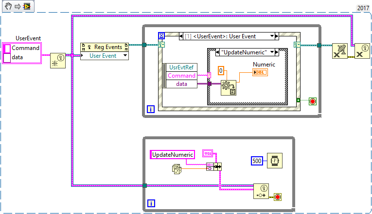

It sounds like a decent start. For communication between modules (and also for indicator updates, but that can be the next step) you should try User Events. A common solution that's very scalable, is to have a Cluster as datatype, with a String and a Variant as data. The string would be the command sent, and since you send a variant it can be anything (although you need to unpack it with a Variant to Data each time)
I've attached a snipped as an idea. As you realize you can have multiple user events if needed, e.g. splitting to/from or different modules, but start with one.
