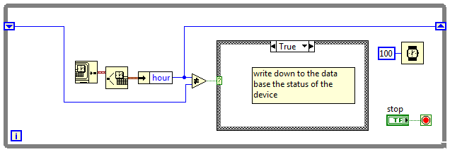

I am making a vi that have to do the next:
* Monitor every hour the status of a device,
* When the time has arrived, write down to the data base the status of the device
Coul you tell me which is the best option to monitor this kind of time (hours)? And whic is the best option to implement it, I am using 2 while loops, one to monitor the status of the device and other to monitor the time. In this way, when the time has arrived then I write to the data base.

You don't need separate loops, put both equipment acquisition and time/compare into 1 loop....shift register stores current and previous 'hour' values, when the hour changes>>compare: if not equal then do your acquisition code.... Smiley Wink  also, please do not post multiples of the same question. eventually someone will answer soon...if not , just bump it

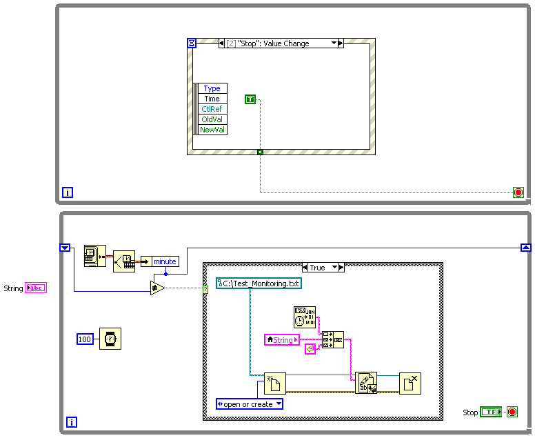

Thanks for your answers, please tell me If the code that I am attaching will work properly. I want to stop the monitoring when an event occurs. Regards

it is hard to understand the whole picture, with just a picture...post the vi please
what event are you waiting for? you need to put the event structure in a separate loop, otherwise your current loop hangs waiting for an user interface....then you can send a dynamic event to that separate event structured loop
