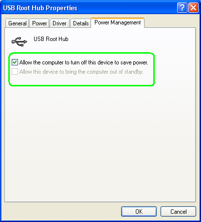

The first thing to look at is the OS power saving options.  There is a global trend towards developing "Green" electronics and energy star ratings are getting fairly common.  "If its not being used shut it off" is nothing new.  Cavemen learned how to bank a fire to preserve energy that would otherwise be wasted.  Likewise, the Windows OS has a power saving feature to shut down power to the USB hubs when no user activity is present.  In Automated systems this feature can cause problems since removing USB hub power will shut down the USB device.   Solution: Use the device manager to change the USB hub Power Options.
