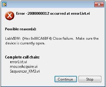

Hi all,
I have problem with mouseAcquire.vi ( Acquire Input Data VI ). Error code –2000000012 Close failure. Make sure the device is currently open. Error appears in startup of application under Operator account. When I start application under Administrator account, it works without error. I made test application only with Initialize Mouse.vi, Acquire Input Data.vi, Close Input Device.vi under Operator account, it was without error.MouseError.JPG

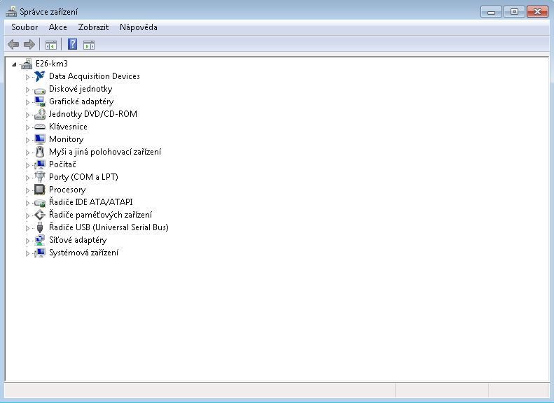

I tried to search device problem but I found nothing.
I don´t know how to reproduce error. That is problem. I only know that appears during startup application under Operator account.

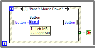

I don't the idea behind the code...to acquire mouse click event I recommend you to use event structure. Here is the example that shows use of "Mouse Down" or "Mouse Down?" event generated by the main Pane of the VI.
