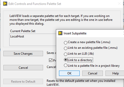

I really do not like the instrument drivers in <C:\Program Files (x86)\National Instruments\LabVIEW 20XX> either!
I am not sure why you would recommend *not* to create palette from those directories. It is pretty simple to do.
I would suggest that you DO use your source code (not user.lib)... or else it will come back to bite you later. IE you tweak the user.lib version of the vi, because that is the one you  are using, then later someone else tries an builds it only to find out that they do not have the tweak you made!
I usually use a common SW directory inside my source code repository directory and use it directly from there... At least you do not have duplicate vi's on your PC... because we all know how much LabVIEW likes that.
