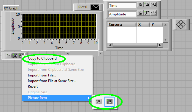

Sure, this is fairly easy, just takes a little trickery.
What you're going to do is introduce three new buttons, one each for the Cursor Movement Tool, the Zoom Tool, and the Panning Tool. Since these new buttons are not part of the graph, you can put them in any pane you want (or even on another VI...). They just need to have access to a control reference or property node of the two graphs you want to control. The property node that sets the active tool is "Pallette >> Active Tool". From help: "Sets the tool that is currently selected on the graph palette. 0 is the selection cursor, 1 is the panning tool, and 2-7 are the zoom tools."
Also, these button can be customized any way you want. If you want them to look exactly like those on the Graph Palette, go to "Customize Control" on any graph, and copy all six decals on those three buttons (shown in image below).
