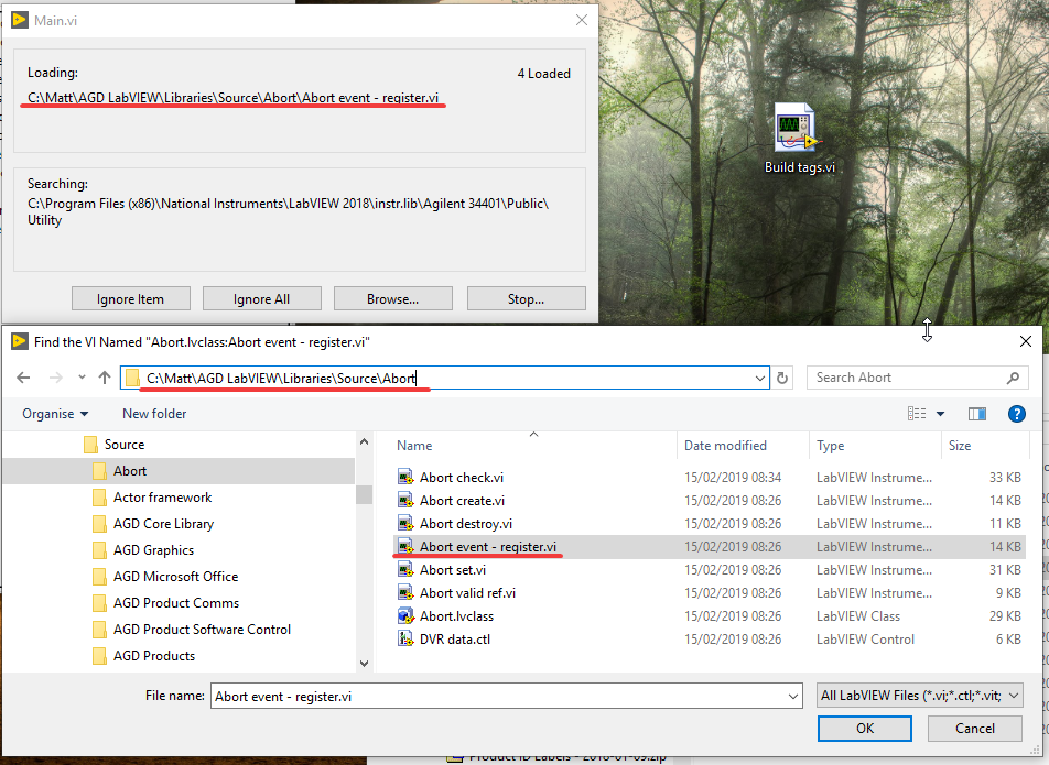

LabVIEW seems to be linking to the original source VIs for some of the VIs in the project which haven't yet been updated to the PPLs while also having links to the PPLs for previously updated VIs. When I open the project, it can't seem to find the original source VIs even through they haven't moved and the path is correct - example below:
As you can see the path is exactly the same! Manually browsing and selecting it fixes it, but it is EXTREMELY tedious for large projects.
Why is it not automatically finding them or at worst having me choose which one to use: PPL or source?
Moments after posting I see why, I had to move Abort.lvclass into its own Library to create a PPL so the namespace no longer matches. Instead of Abort.lvclass:Abort event - register.vi its now Abort.lvib:Abort.lvclass:Abort event - register.vi

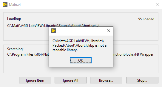

If I try and use the PPL version it works for the first time then when it needs another one linking and I try to open the PPL again, I get the following error:
Has anyone else experienced this?
