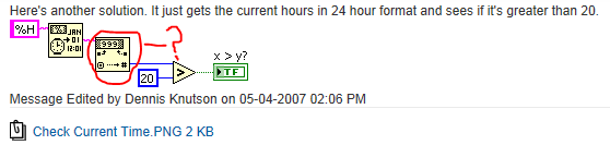

Here's another solution. It just gets the current hours in 24 hour format and sees if it's greater than 20.

Hi Dennis,
I know this is a very old post,  but the info applies to my current task...
I tried to use your example in a little test vi, but for the life of me, I cannot find this icon anyplace on any of the pallettes?
It is the one circled in RED.  What is it called and where is it located???
I have 2010-2012 and cannot find it at all.  Is it some old function block that doesn't exist anymore?
Thanks!
