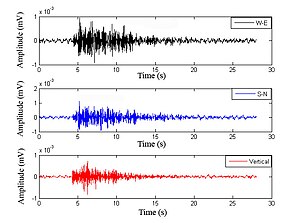

To explain my self better :
I know how to select  the waveform I want to use (I implemented a state diagram for that), my issue is to display those multiple waveform selected as they have the same average value.
It is a bit like a sismograph (https://upload.wikimedia.org/wikipedia/commons/thumb/c/c3/Sisma_three_components.jpg/300px-Sisma_thr...
So, the easiest way would have been (in a "static" approach) to just put 4 graphs one under the other. But as I got too many signal to display I have to find a way to implement a dynamic approach that automaticaly set the size of the graph.
The Mixed Signal Graph just seemed to organize those plots, my question is if there is another way to do that with the same data type.

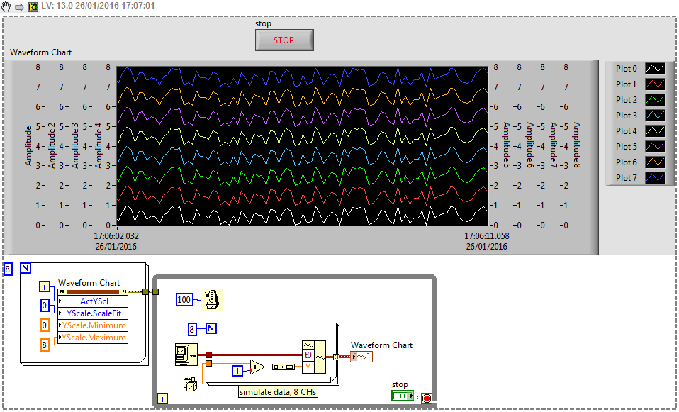

Right now only one thing comes to my mind: use multiple y-axis. It looks ugly in my example, but I am sure you can improve it.
Also, you have to dynamically figure out how to shift your waveforms in y-axis direction so they do not overlap. You can use a multiplier, etc... It is also common in scientific publications, where we wanna show multi curves not overlapping, you just shift them with a multiplier, and you indicate this fact in the corresponding y-axis title text...
You could also make all y-axises invisible, except the first, so the Graph or Chart will not look crazy/overcrowded...Like this:

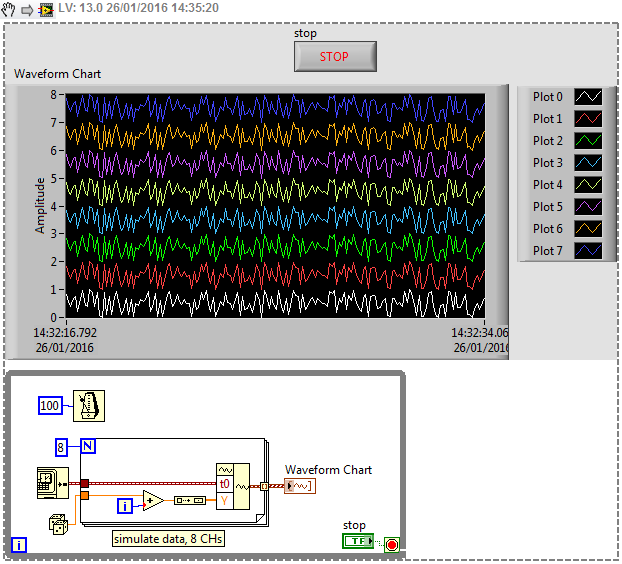

Ok, i think i am too tired, what i created, is a Rube Goldberg code :)))
Obviously you can just use a single y-axis for the second VI... 🙂
So the trick would be how to shift the curves so they are nicely visible. And you use one single Graph + 1 single y-axis.

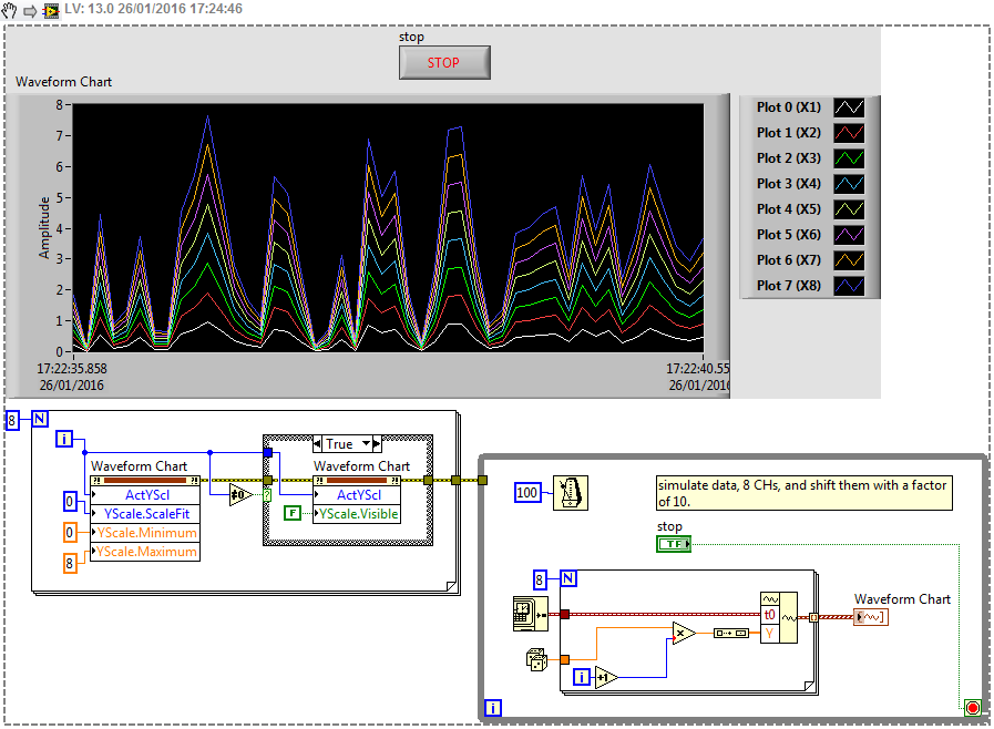

You also have to figure out the best way not to distort the shapes. So for example, usually an addition is better than a multiplication, see the difference between the first and the second Charts. But this also depends on the axis, for example for a logarithmic Y-scale, a multiplication would only appear as a simple linear shift...
