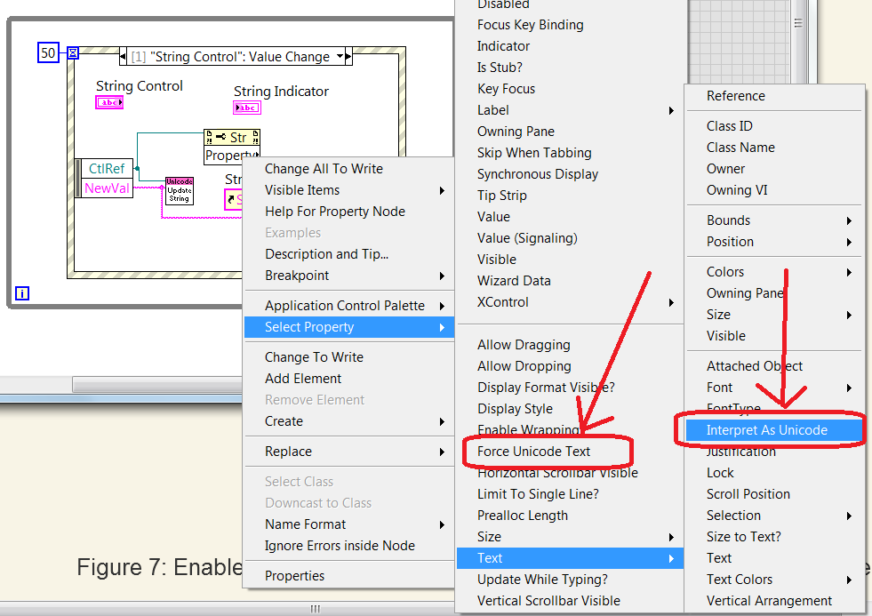

Thanks a lot, I am still searching for the code with the event structure to update the control.
Regarding the property nodes Text.InterpretAsUnicode and Caption.InterpretAsUnicode, I did not found them in the string indicator/control. Even if I set the UseUnicode=True in the LabVIEW.ini.
Is there a way to find these property nodes ?
Thank you.
(5,763 Views)
Add the key "SuperSecretPrivateSpecialStuff=true" in the LabVIEW init file (https://lavag.org/topic/15869-what-exactly-is-supersecretprivatespecialstuff-for/) you will have access to those properties:
(5,732 Views)
Awesome !! Thanks a lot. I think that with all of this, I should be able to make something that works.
The name of the key made me laugh ^^ At first, I tought it was a joke.
