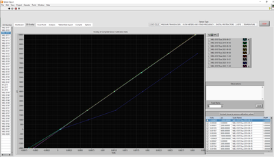

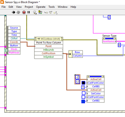

I have the ActiveCell defined as shown below.  That wire diagram also shows my current configuration of the other parameters.  It allows for the highlighting of the ActiveCell.  It also allows, for the most part, the un-highlighting of the 1st cell, when the 1st cell is not selected.  However, there is still a dotted box around the text of the 1st cell as shown in the other screenshot.  I have the Selection Mode set to not highlight the entire row.  When I turned Highlight Entire Row on and turned SelColor to transparent, the actual SelColor was not transparent but was translucent.  Therefore, I determined the current configuration was my best option.  Now I just want to eliminate the dotted box around the text.  It does go away when I click off of the listbox.
Well, that's not the same code you showed before, and it's only a partial image of the code, but if you don't care about the value of the control, you can disable it (or make it an indicator and feed it a value of -1, so that it's not selected) and just keep your existing code for highlighting a specific cell (with whatever logic you have for cancelling it later).
