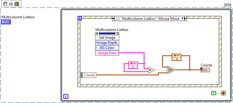

So if you're looking for something something clunky, here's an option:
It's not the whole solution but I think it might get you there. You'll need to combine it with the actual cell position, filter out clicks that aren't on the horizontal scrollbar, add a MouseDown event to get your "starting point", filter out the vertical component of motion, and a few other things... but this will get you relative scroll motion 🙂
Basically the only readable thing that's changing as far as I can tell is the image of the listbox. If you just use "Mouse Move" events then it'll fire all the time, and even if you filter when it's just over the scrollbar the event still fires at the end of the scrollbar.

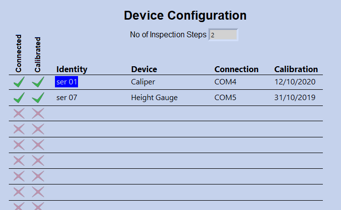

I had this very problem and my solution was the put my symbols in a seperate, adjacent listbox. When the user scrolls horizontally in the main listbox the symbols remain in place. For me this had the advantage that the status symbols remain visible. If you have many columns then you can move any number of columns to the horizontaly static listbox so when the user scrolls across the main listbox the column entry that is used to identify the row remains visible.
In this example the connected and calibrated columns are in a different listbox to the rest of the data. I made everything transparent and added my own seperators. I did initially put it all in a cluster to give it the appearance of being a single entity but I prefer this solution.
Andy
