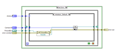

I have created an action engine that is used to control a camera. The action engine has the following actions:
  • Initialize
  • StartAcquiring
  • RenderImage
  • StopAcquiring
  • LoadParameters
  • Exit
The action engine functions on a .NET reference that is saved in a USR. However, I want to create multiple camera objects that are identified by the CameraID and for that I would need multiple .NET references. Two options I can think of right now are, making a case for every CameraID that each contain a separate USR or duplicating the function for every CameraID. But I don't really like these solutions. How would you go about doing this?

When I run into this I just stuff the USR with an array of refs and make "Channel " or "Device Index" a required input.  This avoided a lot of duplicate code at the cost of a IPE between the while and the case
Using a FBN instead of a single iteration while loop cleans it up very nice.

I was also thinking about doing it like this, using classes is something I still need to get used to.
