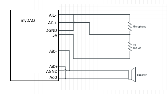

I have attached a copy of my circuit below.
Yes, I am using the MyDAQ. I considered the sampling rate issue, however even when I decreased the rate to around 5KS/s the problem persisted.

I notice that you have one side of the microphone wired to digital ground but have what appears to be a differential connection for analog input. There are two possible problems with that. One is that digital grounds are often much noisier than analog grounds, event though they may be connected internally to the DAQ device. Noise on a digital ground which is substantially larger than a typical micorphone signal is not unusual. Second is that there is no advantage to using a differential connection with a single ended signal source, such as your microphone. Any noise on the Ai1- input (from DGND) gets added to the signal.  This will not be common mode noise that can be removed by a differential amplifier.
Is the MyDAQ analog output capable of driving a speaker? I have not looked at the specifications but it is unusual to find a DAQ device which can generate more than a few milliwatts at an analog output.
The 5 volt power lines on most DAQ devices may carry a significant amount of "digital" noise. This appears as spikes on the line which occur at the time of switching of digital circuits powered by the line. That noise may appear on the microphone output. The 1 mVpp noise in the first 2.5 ms of your 1 Channel Waveform in the original post could well be that type of noise. Splitting R1 into two series resistors and wiring a bypass capacitor from the resistor junction to ground may reduce the noise at the microphone connection.
Regarding your two-channel issue: It may be ghosting. The source impedance of the microphone signal is probably quite high. If you search the Forums for "ghosting" you will find many related posts.
