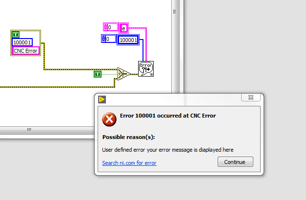

I don't see anything fundamentally wrong with running multiple error clusters if you would like to log them differently.
If you wanted to log any specific errors immediately, but wanted to continue programmatic flow instead of ending the VI upon encountering the error, you could unbundle the error cluster and make a case structure for that specific error and then log it to a .txt file.
If you're worried about LabVIEW not being able to properly handle the errors being thrown by different pieces of hardware, you could also write your own custom error codes.  This would imply that the standard LabVIEW error cluster would be enough to handle your use case.

Why not define your own error codes and messages and use the same error cluster? Then based on the error code you decide how to log them

You filter by error code. In addition to all of the defined error codes built into LabVIEW functions, LabVIEW permits user error codes within the ranges -8999 to -8000, 5000 to 9999, and 500,000 to 599,999.  That should be plenty for anyone.
When I build an application, I might assign a block of codes to one particular process, such as 5100s for acquisition, 5200s for analysis, 5300s for logging to disk, etc. This is where the SEH library is useful, because you can assign an action (such as calling a VI) to a range of codes, instead of having to handle them individually.
