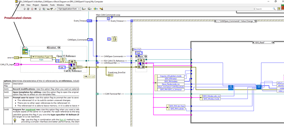

Hello ,
I tried the FGVs with "Preallocated clone reentrant execution" , but this solution is not clean because the Main VI's which are clones are not able to seggregate the FGV's. I get data which is jumbled  which is contraproductive.
Best
Akshay
Message 5 of 11
(2,059 Views)

I would ditch the "Open VI Reference" part as that is unneeded (as you are just creating a second clone and never using the first one), but otherwise that should work.
A reference image for FGV by reference (no Open VI ref):
Message 9 of 11
