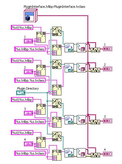

multi plugin.JPGThanks for the responce,
Is this what you meant by  "You can call this as many times as you want to get multiple instances"
I'm not sure what you're asking. Does this code do what you need it to do, and work the way you expect?
To save some duplication, you could also put most of this code into a for loop to get an array of four objects, and then index them out and cast them to the correct type.
