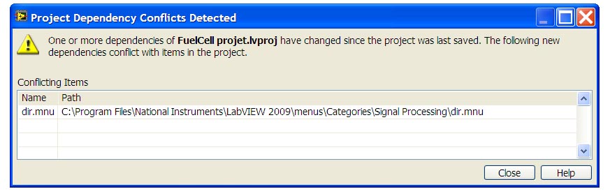

There appears to be a new variation of this issue in LabVIEW 2009.  Within NI_AALPro.lvlib (menus->Categories) there is a dir.mnu that is conflicting with a dir.mnu in an lvlib in my user.lib folder.
Message 6 of 10
(6,106 Views)
I also have a similar message (LV2009).
J-M
Message 7 of 10
(6,091 Views)
For now, this is going to bite you ewhenever you have files in libraries that have conflicting names - cross library mislinks as well. The only solution is to avoid putting commonly named palette files into your libraries/class/XControls.

Thanks Gavin but unfortunatly it is not solve my problem.
I made a little bit of cleanup and I compared the labiew project under 8.6 and 2009.  I think I was wrong: the problem seems to not be related to LV2009.  Just before the LV2009 upgrade, I have created 3 global variables.  A LV8.6 backup, without the global variables, do not shows this message (8.6 and 2009). Another backup (the last with LV8.6) with the global variables shows this message.  I removed the global variables but the problem is still there. I am not convinced at 100% but the problem seems to be this modification.
Jean-Marc
Message 9 of 10
(6,002 Views)
Sorry,
I created Share variables not global variables.
JM
