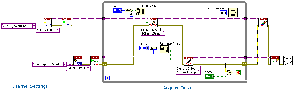

I am a french student in England for a summer internship and I am working on a prototype of Electrical Capacitance Tomography (ECT). Indeed I am developing all the electronics of this system with the help of the Elvis Board and Labview. My actual task is to design a multiplexer/demultiplexer I need to supply my sensors and collect data from them on Labview.
My system have 12 sensors which are electrodes and my aim is to calculate the value of the capacitance between two electrodes. I supply one of these electrodes by a positive voltage and the others by the ground and I have to find the capacitance between the electrode supplied by a positive voltage and each one supplied by the ground. So I will use a demultiplexer to supply all the electrodes in a specific order with a lookup table on Labview; with the digital output and the DAQ (Input) assistant it will be okay I think. In attachment I put a scheme of a system which permit to convert the value of this capacitance in a sine. In this scheme the capacitance of 150fF (on the left) is the one between two electrodes, so the crosspoint with the other capacitances is where I want to connect one of my electrodes and the other extremity of the capacitance of 150fF at a second electrode. But I want to choose what electrodes connect to my system, and it is the purpose of a multiplexer (here I need two of them).
My problem is the next:
How to design a multiplexer (probably commanded by a look up table) on Labview, using 12 different signals (voltage) from the Elvis Board? Because with the DAQ (Output) Assistant I can recover the 12 signals (if I find 12 ports for this) but after I don't really know how to select such or such signal according to a precise lookup table or timing I don't know. Because I know the basics in Labview and a little more now but this seems very complex.

you can use a 4-16 line decoder to a 3 x cmos quad bilateral switch and common the output. write 4 digital lines to each decoder to control what analog switch to output.

I fix my problem.
So thank you for your help 😄
